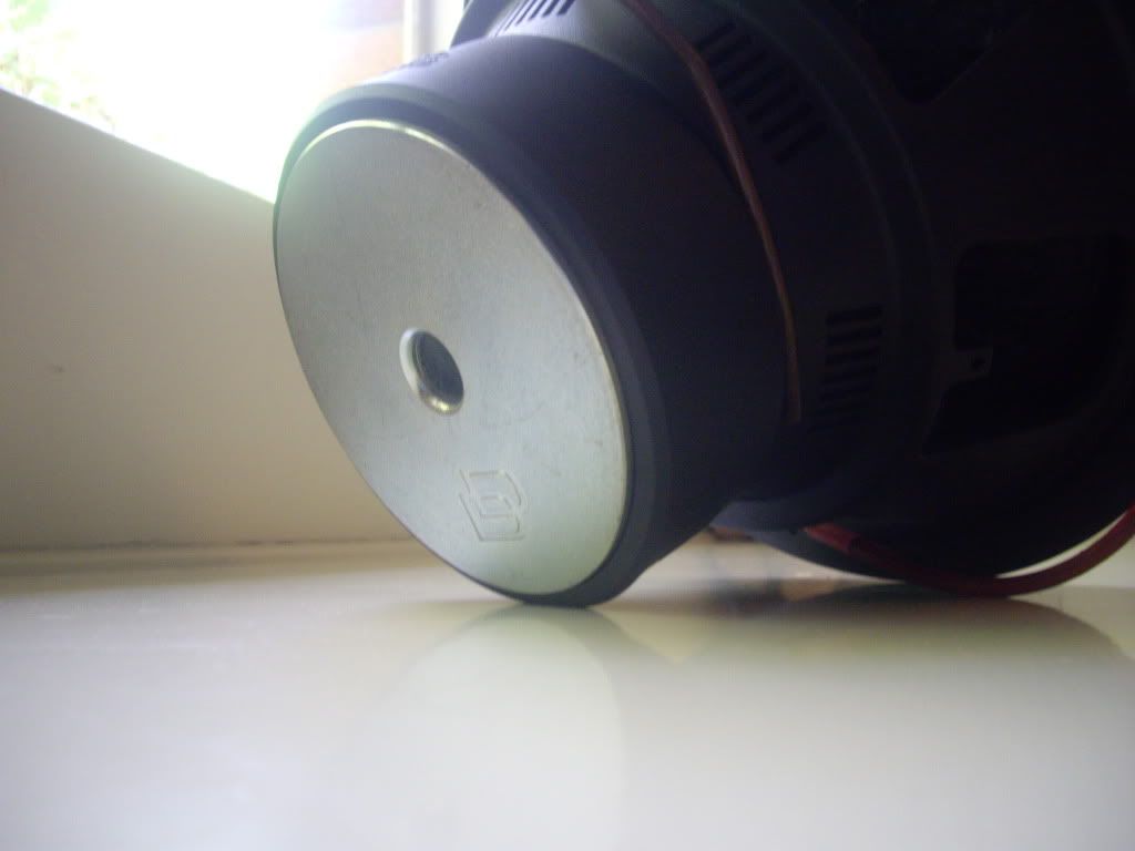

Stamped steel basket with cooling slots around the top of the motor, you can view the 2inch coil :)
Glue job on the dust cap was reasonably neat as it was on the surround and spider, once again better than i had expected.
This photo highlights the motor structure next to the motor from a Jaycar Venom 15, if there was anything to pick on it would be that the motor has some chips and the stacks do not line up exactly, this would normally have been covered by the rubber boot that the drivers comes with and does not effect performance in anyway...
