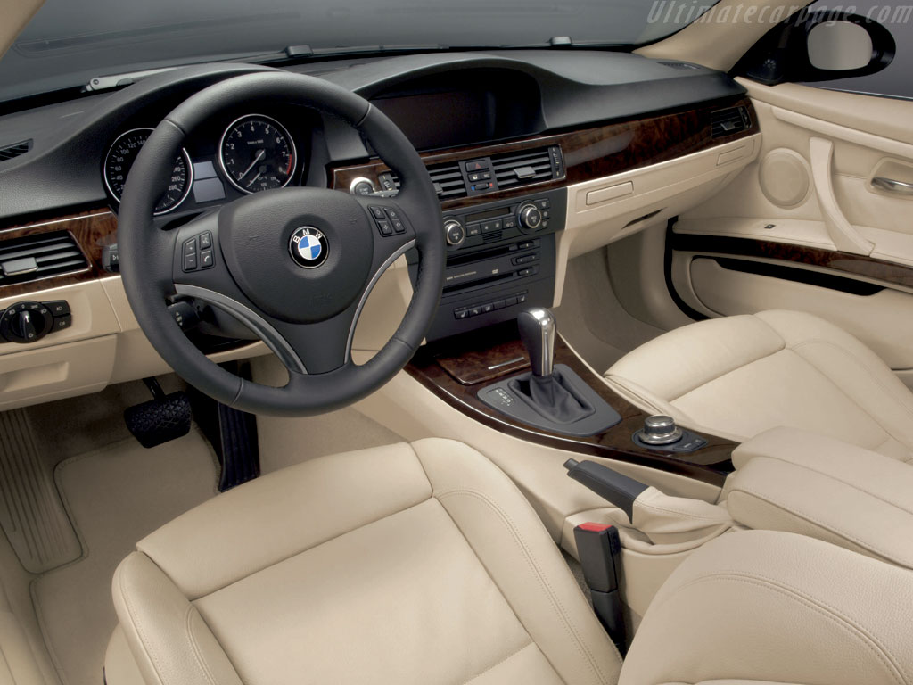

Hi Antonio :)
I'm quite BMW biased, so I'll be saying the E92 coupe :)
Just look at the interior:
WHY WOULD YOU NOT???
The Supremo 2 ways are supposed to sound the goods. I've heard the Elate 3 ways myself and was MEGA impressed. So either one of those would be tops in that car.
BMWs and Genesis is the picture I'm getting in mind. ESPECIALLY with that Ultimo sub.
You planning on going active or passive?
