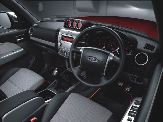

The latest shape has a completely different (read integrated) dash design, much like a VE Commodore or FG Falcon. The earlier PK Ranger (like BDL Car Audio's) has a simple replacement double din facia and more conventional wiring.

There probably isnt a facia available yet..
2011 Ranger interior
2007 PK Wildtrak
With aftermarket fascia

yea i didnt think there would be one but i was thinking along the lines of customs made...

I have done 3 now without issue. panel does not exist (I have been looking in thailand) and as far as adding accessories to the thing - nothing special. I have been stick UHF radios in them since they came out.

With the Panel if we ware talking about the factory H/U face plate thingy i was talking about a costly custom job not pre built as its only just come out so i knew there wasnt gonna be one.

I often have panels 6-7 months BEFORE the cars are released here. japanese cars especially.
