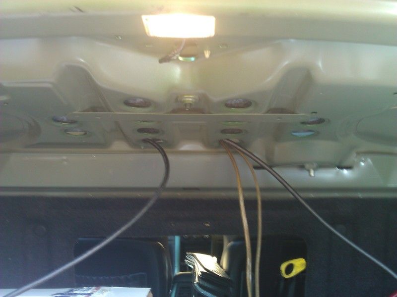

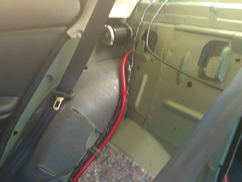

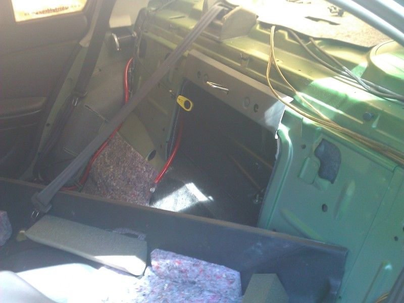

Ok, the install has begun.
I have pulled the back seats out and started running the cables down either side of the car and into the boot. I have run the RCA's and two speaker wires together down the passenger side. Is it ok to run the speaker cables with the RCA's?
The speaker and RCA cabling to the amps will be run up on top of the rear parcel shelf and drop down the existing holes to the amps.
I will also be relocating my battery to the boot and are going to run the battery feed, the other two speaker wires and the amp remote turn on cable down the drivers side.
I also made up a bit of ply and carpeted it to mount the amps up under the rear parcel shelf.
I still need to get some dynamat and do the parcel shelf etc while the seats are out.
Some pictures of the mess so far are shown below.
Cheers
Benno

Posted 16 June 2012 - 08:11 PM
Looks good so far. Only thing i would suggest is run the drivers side speaker wires under the dash to the passenger side and up the passenger side to the boot. That helped eliminate a slight alternator whine in the drivers side tweeter in my car.

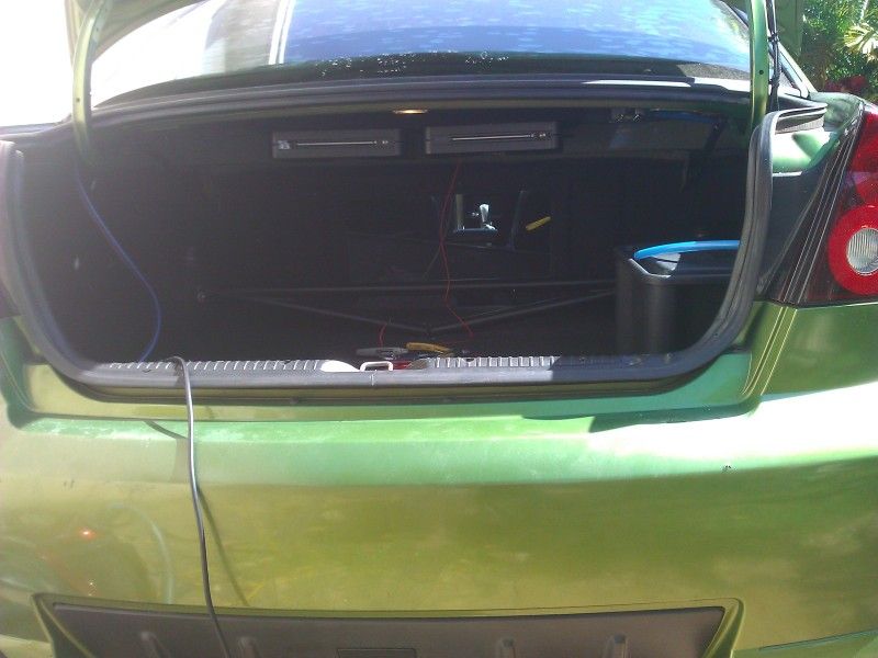

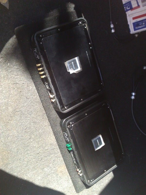

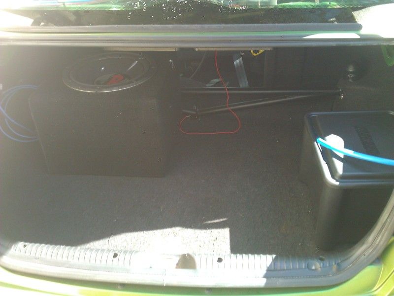

Posted 06 July 2012 - 06:41 PM
A little bit of progress made today. I'm aiming for a nice simple install that is fairly hidden. Starting to like how its turning out.
The sub shown is an old one I have had in the cupboard for years. This will be used at first until I order a Peerless XXLS and make up a new box etc.
Next thing will be to finish of the wiring for my battery relocation, some dynamatting and start putting the back half of the car back together.
The front stage is going to be scanspeak mids / tweeters in the factory locations and running active I have decided.
Cheers
Benno
