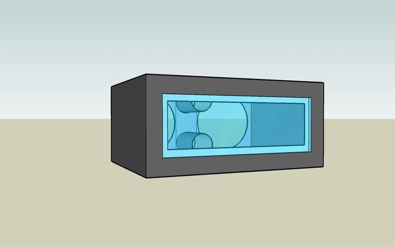

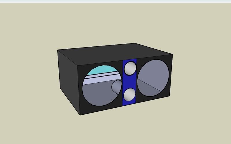

May 3 2008, 01:23 AM
Click Links for PicOk the first 2 are a quick Google sketchup done to the sizes in the 3rd pic (not exact as sometimes it refused to do exact inches.
On the 3rd one i used the MEA app to calculate the ports etc. Does it look all right? The Sub specs say 2 cu ft3 optimum with the ports displacement already taken out theres like 4.2cuft3 and sub displacement is .1 i just don't no if it is ok to have both subs in one box (not via divider) and for them to share the 2 ports? Any info or help with this part would be great i have gotten this far atleast lol.

There it is so any idea on if this is right?
DD Phil
May 3 2008, 04:05 PM
Looks OK to me.
